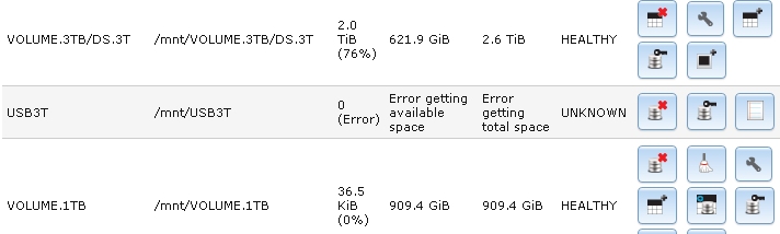

also.. Ive rebooted a few times since this morning and it dosnt seem to make a difference.
For the record - this used to work - I dont know of changing anything other than it stopped appearing in the add - volume menu
see attachment

While posting I realised the USB3T was not in /mnt so I created it. From what I recall this was done automatically as I dont think it would survive a reboot
[bob@DIME521] /mnt# mkdir
detach and attach the drive
[bob@DIME521] /mnt# camcontrol rescan all
Re-scan of bus 0 was successful
Re-scan of bus 9 was successful
[bob@DIME521] /mnt# ls -lrt USB3T/
total 1
drwxr-xr-x 2 root wheel 512 May 28 22:56 ./
drwxrwxr-x 6 root wheel 512 May 28 22:56 ../
[bob@DIME521] /mnt# gpart show da1
=> 63 732565953 da1 MBR (2.7T)
63 193 - free - (772k)
256 732565760 1 ntfs (2.7T)

weird from the begining I tried to mount as ntfs-3g /dev/da1
and wasnt working... needed the s1
Thanks for walking through this !! Im running late here...
How about my other question as far as the usefulness of view disks. I dont see any value there.
There is no way to "view new disks" or add disk - what happened to the + sign.
That would avoid having to figure out mounting it manually.
The edit window is minimal as far as being useful and there is no way to remove very stale entries.
Im seeing myself having to mount it by hand every time. The drive is used as a removeable backup to the main system.
