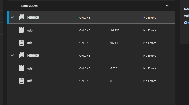

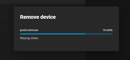

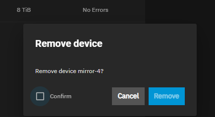

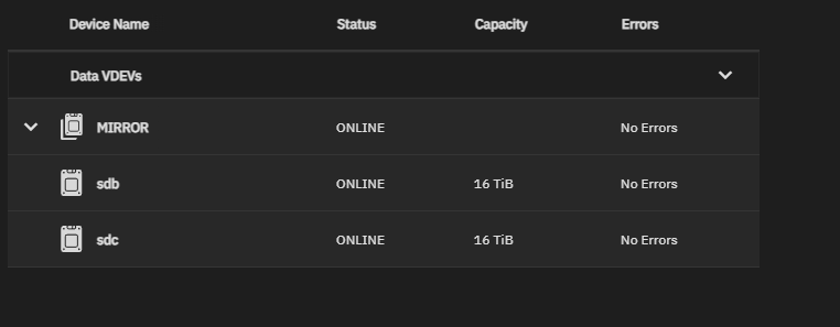

I'm testing in virtual environment adding and removing mirrors and it seems to be working
I 2 mirrors
I'll click remore second mirror. There is no error.
pools is still online, share with test file is still online.
So as long as free space on the pool is lower that lowest mirror it will be possible i'm assuming ?
If data is scattered on all mirrors during remove vdev it will be rebalanced to mirrors that was left untouched ?
is such adding and removing mirror vdev is now safe?

So if i don't have sufficient space on pool will i get error and vdev removal will not be possible ?
HoneyBadger
actually does care
Administrator
Feb 6, 2014
5,112
Correct; you'll get a pop-up dialog stating that there isn't enough free space left in the pool, and the removal will be cancelled immediately.
