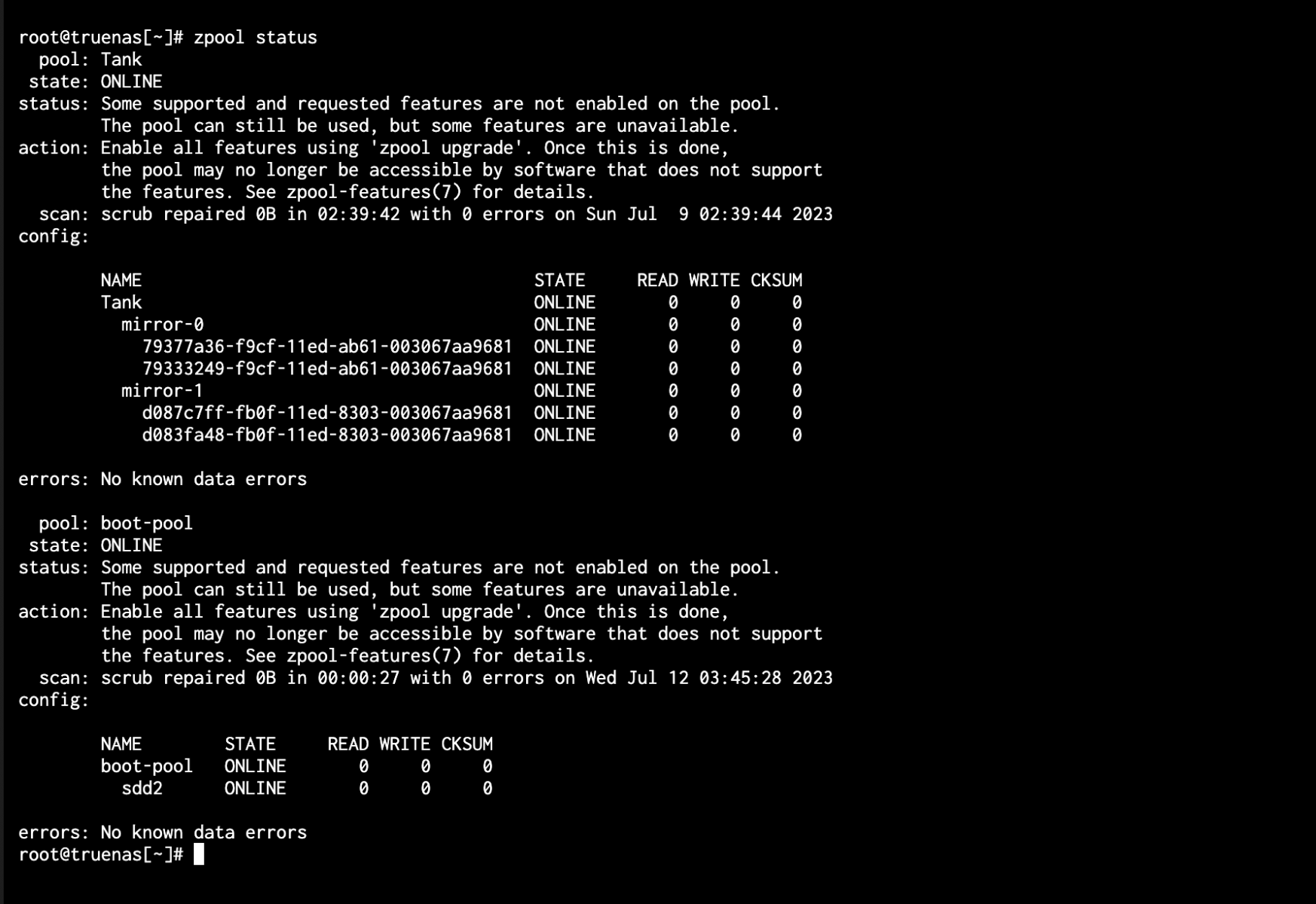

My question is this: Can I add 2 more 2 TB hard drives to my pool without having to rebuild everything?
I know that the best way to increase storage is just to add the same number of drives again to a different vdev and then add it to the pool, but unfortunately I don't have enough SATA ports to support 8 drives. I was hoping that since I am adding 2 more similar drives (which i would also mirror) that it might work ok, especially since my current pool isn't actually 1 vdev with 4 drives, but 2 vdevs with 2 drives each. (picture of the current config below)
So what do we think? Can i just add the 2 more drives, make another vdev and add it, or do I need to recreate the storage pool?
Yes.
Storage | Manage Devices (for that pool) | Add VDEV.
You would perhaps also want to consider a rebalancing, either by emptying the pool and putting the content back (from backup or whatever), moving data to new datasets, deleting old and renaming back to original, or running the in-place rebalancing script: https://github.com/markusressel/zfs-inplace-rebalancing
