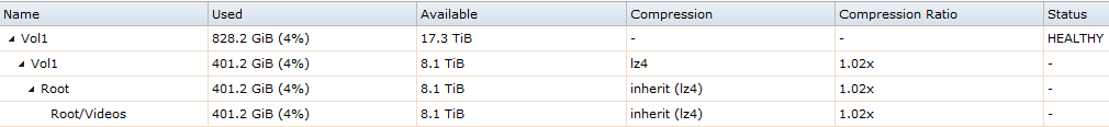

OK, I think I've straightened it out. In FreeNAS, the owner (user) is nobody, and the owner (group) is Domain Admins. I made a dataset and share together called Root, and a dataset and share within Root called Videos. Then, in Windows Explorer, I added the Communications group to the Videos folder. I removed "everyone" from Root and thus Communications as well.
However, Communications was still denied. The solution to seems to be giving Communications access to Root as well. I understand the logic... if you don't have permission to write to the parent zvol, you wouldn't be able to write to the child, either.
Now I don't know what I would do if I wanted another share besides Videos that I did NOT want Communications to have access to. Would I have to make another zvol at the same level that Root is at? Was it mistake creating Root with Videos as a child?
It now seems as though the most efficient thing would have been to create the Videos zvol at the level where Root is at, and that's it. Then, to adjust permissions to Communications, I could just browse the network in Windows Explorer (\\Marty\) and adjust the share permissions that way.
I've attached a screenshot of the storage hierarchy for reference.
Thinking all you need to do is just create the single DataSet and Share; Set the "Owner (User)" to "nobody" and the "Owner (Group)" to "Domain Admins".... As you have already done
  1. Now, in Windows Explorer; connect to the "Root" Share.
    • Thinking it should be "\\Marty\Root"?
    • Authenticate with credentials of an account that is part of the "Domain Admins" group
  2. Create a folder in there and call it "Videos"
  3. Right-Click on the newly created "Videos" folder; Select "Properties" then "Security"
  4. Change\Set the permissions as desired
    • Thinking you want to Add "Communications" Group
      • You can grant them "Full Control"; if you want members to be able to add folders\files and set permissions
      • You can grant them "Modify"; if you simply want to allow members to be able to add folders\files and but NOT set permissions
      • Etc...
    • Leave "Domain Admins"
    • Remove anything else
If you wanted to add another folder and prevent "Communications" Group from accessing it and have another group (Say "Accounting") then:
  1. Create the "Accounting" Group in FreeNas
  2. Create/Add User accounts and make them a member of the "Accounting" Group
  3. Browse again to "\\Marty\Root"?
  4. Create a folder in there and call it whatever you want
    • Add the "Accounting" Group and set Permissions accordingly
    • Ensuring that the "Communications" Group is NOT listed or Removed if it is listed
Keep in mind that when testing this on a machine, you will/may have to clear cached credentials. This can simply be done by executing "Net Use /Delete *" from a CMD Window as the current User (Not an Administrative CMD Window). It will delete all cached connections and allow you to easily test using another set of credentials.
Hope this wasn't too confusing...
