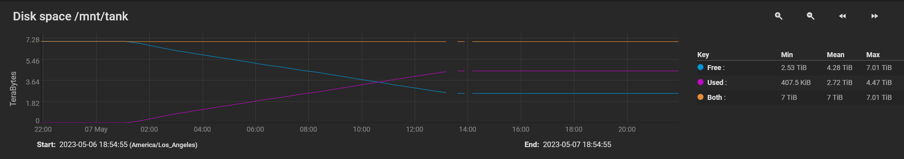

Yesterday, my NAS running TrueNAS-13.0-U4 began to feel sluggish while editing videos from it. I checked the UI and found that it was performing a weekly scrub, so I brushed it off... until I saw that the pool usage was increasing quickly. After stopping the scrub, the used space still kept increasing. I decided to restart the NAS and everything seemed to resolve. After the fact, I have now checked the reporting tab to see that, within ~12 hours, the free space fell from ~7TB to ~2.5TB without any data being written from any machine on my network. Now I have about 4.5 TB of data which is seemingly used by absolutely nothing. All machines on the network have been checked for malware. Checking the pool datasets, nothing seems wrong, and the correct data usages are being shown, except the used and free space account for that new 4TB of 'ghost data'.
The specs of my NAS are as follows:
OS: TrueNAS-13.0-U4
Processor: Intel i5-4570
Memory: 8GB DDR3-1600
Drives:
(6) 4TB HGST Ultrastar 7K4000 HDD
(1) Kingston 120GB A400 SSD
Configured in raid-z2
I am assuming this could have been some freak data leak or glitch in the OS. My main concern is this 'ghost data' taking up 4 terabytes of space on my NAS. I can provide any extra details if necessary. Thanks in advance for your help!

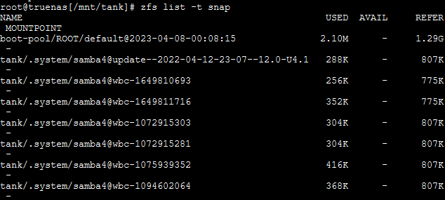

Do you have any snapshots taking up space? What's output of zfs list -t snap look like?

Those are just the system dataset and they don't take up much anyway. Looks like your phantom space is somewhere else.
