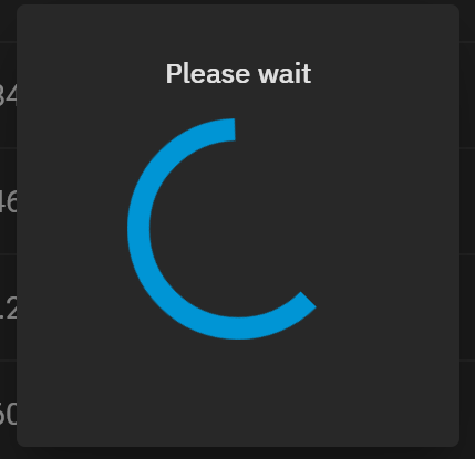

When i try to delete a dataset using the GUI, it just sits spinning (since upgrading to the new version)

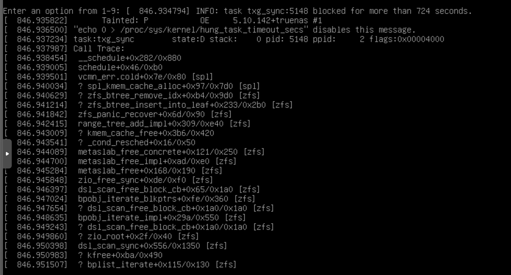

If i check the IPMI this is what i see looping over and over
Eventually the interface times out, i log back in, the dataset is still there, rinse and repeat. I've tried rebooting etc, to no avail
I'll save a debug, roll back to the previous version and try again
