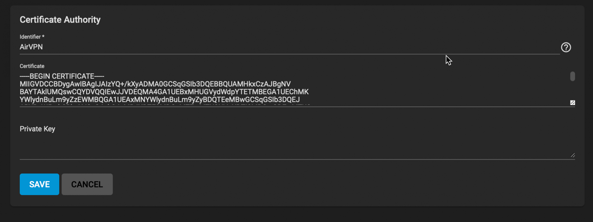

Under system -> CA, I've created a new CA (NordVPN_CA). There I selected "import CA" and I filled in the certificate that I could extract from the ovpn-configurationfile I received from NordVPN. NordVPN does not give a Private Key in their configuration file, so I can not fill in the Private Key field under CA. (see screenshot1 attached)

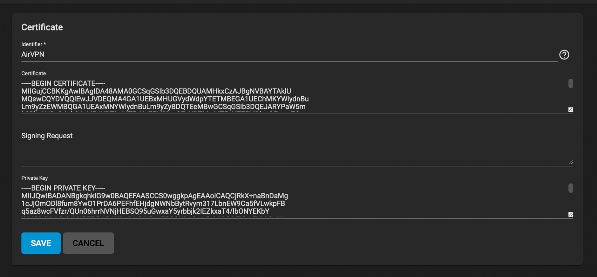

Then I go to system -> Certificates -> Add -> import certificate. There I can fill in the same certificate as I filled in in the CA, but I really don't know which private key I have to fill in there. (see screenshot2 attached)

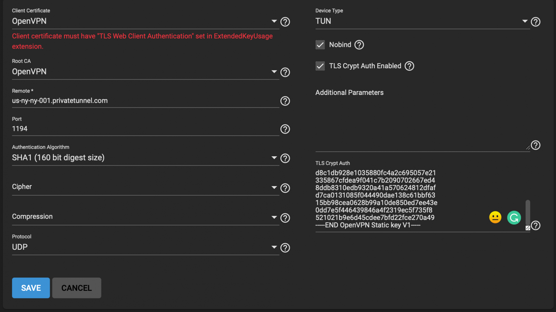

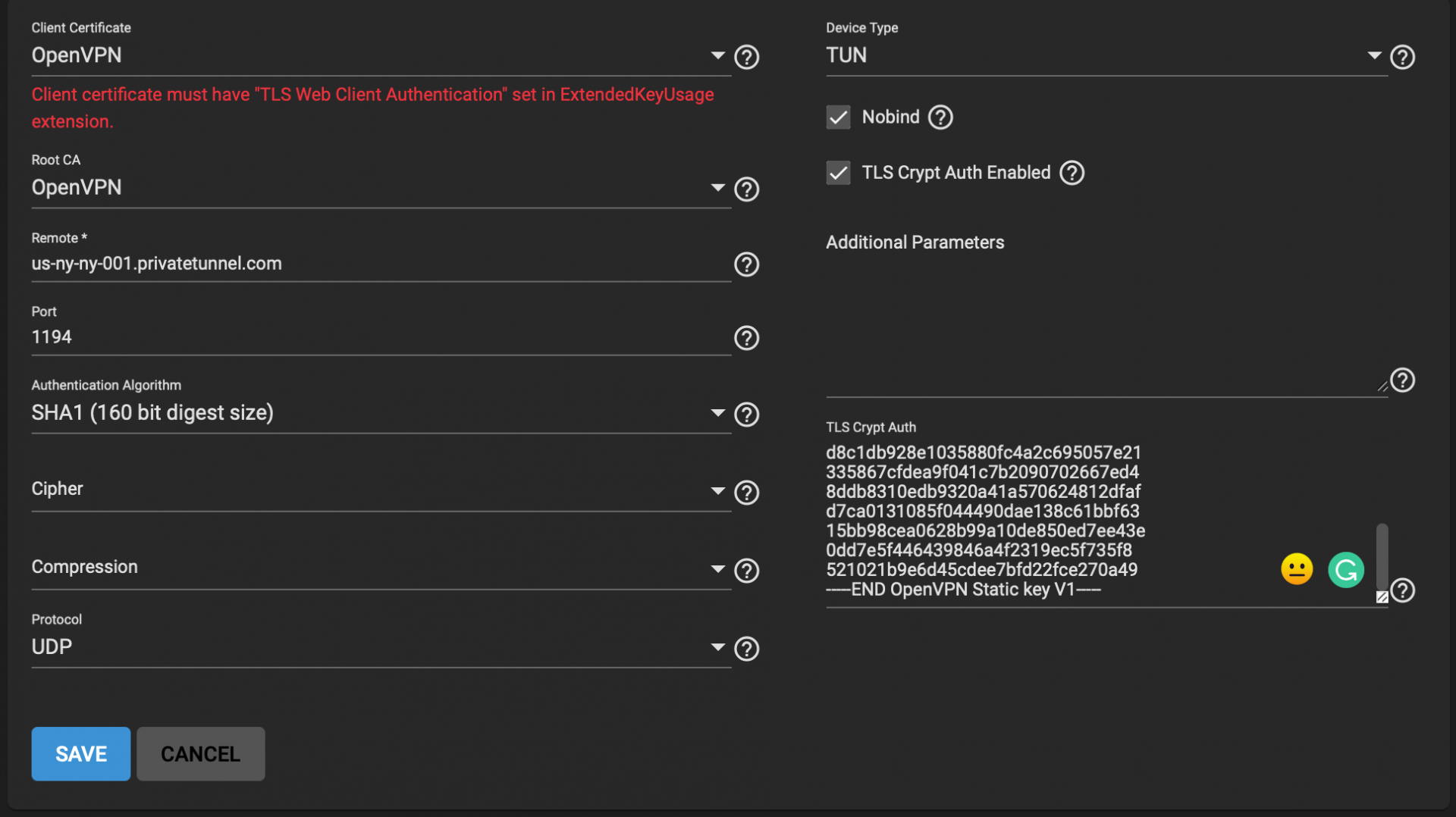

Then under services I fill in all parameters (screenshot3)
When I turn the switch to activate the OPENVPN CLIENT service, it runs, but when I do an IP-address check (curl ifconfig.me ) it returns my ISP IP-adress, and not the IP-address of the VPN.
