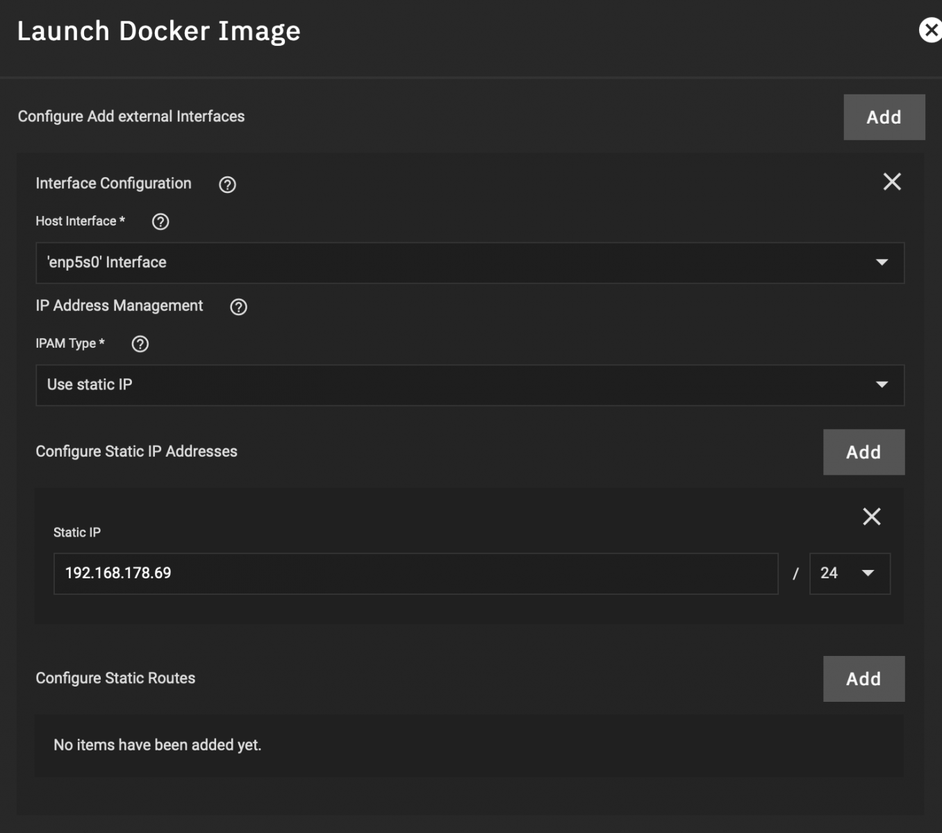

So WOL is broadcast traffic and needs to be on the same physical network layer. Within the backend of the Apps are some different subnets and virtual switches. That is why this will not work as you are using it. Try this config where you can bridge the App to the physical NIC on the TrueNAS system. Replace the Host interface with the interface that your TrueNAS system uses for it's connectivity and then under the static IP, put in an unused static IP that will work for your LAN.
pixelwave
Jan 26, 2022
174
I did put it in like that ... and started the app via http://192.168.178.69:8123. But the WOL command does not work again in HA. :(
