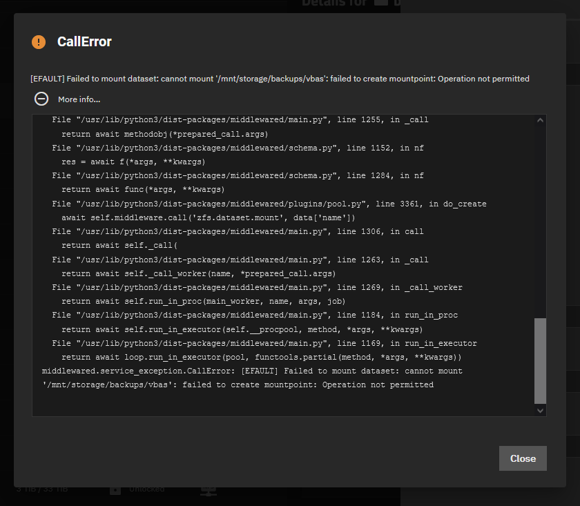

After upgrading some of my datasets will not unlock.

When creating a new dataset named "vbas" with default settings (inherited encryption from "backups" dataset) to move the files over to, the UI returns an error.
Error: concurrent.futures.process._RemoteTraceback:
File "/usr/lib/python3/dist-packages/middlewared/plugins/zfs.py", line 1038, in mount
dataset.mount()
File "libzfs.pyx", line 465, in libzfs.ZFS.__exit__
dataset.mount()
File "libzfs.pyx", line 3969, in libzfs.ZFSDataset.mount
libzfs.ZFSException: cannot mount '/mnt/storage/backups/vbas': failed to create mountpoint: Operation not permitted
File "/usr/lib/python3.9/concurrent/futures/process.py", line 243, in _process_worker
r = call_item.fn(*call_item.args, **call_item.kwargs)
File "/usr/lib/python3/dist-packages/middlewared/worker.py", line 115, in main_worker
res = MIDDLEWARE._run(*call_args)
File "/usr/lib/python3/dist-packages/middlewared/worker.py", line 46, in _run
return self._call(name, serviceobj, methodobj, args, job=job)
File "/usr/lib/python3/dist-packages/middlewared/worker.py", line 40, in _call
return methodobj(*params)
File "/usr/lib/python3/dist-packages/middlewared/schema.py", line 1288, in nf
return func(*args, **kwargs)
File "/usr/lib/python3/dist-packages/middlewared/plugins/zfs.py", line 1041, in mount
raise CallError(f'Failed to mount dataset: {e}')
middlewared.service_exception.CallError: [EFAULT] Failed to mount dataset: cannot mount '/mnt/storage/backups/vbas': failed to create mountpoint: Operation not permitted
The above exception was the direct cause of the following exception:
File "/usr/lib/python3/dist-packages/middlewared/main.py", line 181, in call_method
result = await self.middleware._call(message['method'], serviceobj, methodobj, params, app=self)
File "/usr/lib/python3/dist-packages/middlewared/main.py", line 1255, in _call
File "/usr/lib/python3/dist-packages/middlewared/service.py", line 922, in create
rv = await self.middleware._call(
File "/usr/lib/python3/dist-packages/middlewared/schema.py", line 1152, in nf
res = await f(*args, **kwargs)
File "/usr/lib/python3/dist-packages/middlewared/schema.py", line 1284, in nf
File "/usr/lib/python3/dist-packages/middlewared/plugins/pool.py", line 3361, in do_create
await self.middleware.call('zfs.dataset.mount', data['name'])
File "/usr/lib/python3/dist-packages/middlewared/main.py", line 1306, in call
return await self._call(
File "/usr/lib/python3/dist-packages/middlewared/main.py", line 1263, in _call
return await self._call_worker(name, *prepared_call.args)
File "/usr/lib/python3/dist-packages/middlewared/main.py", line 1269, in _call_worker
return await self.run_in_proc(main_worker, name, args, job)
File "/usr/lib/python3/dist-packages/middlewared/main.py", line 1184, in run_in_proc
return await self.run_in_executor(self.__procpool, method, *args, **kwargs)
File "/usr/lib/python3/dist-packages/middlewared/main.py", line 1169, in run_in_executor
Refreshing the page shows the new "vbas" dataset, but it is "locked by ancestor".
Edit: created a bug report: https://ixsystems.atlassian.net/browse/NAS-119836

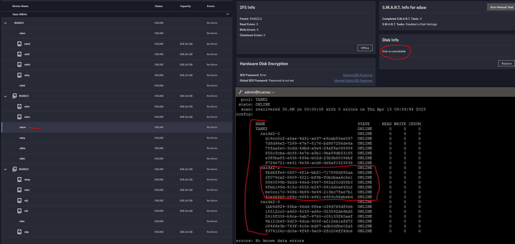

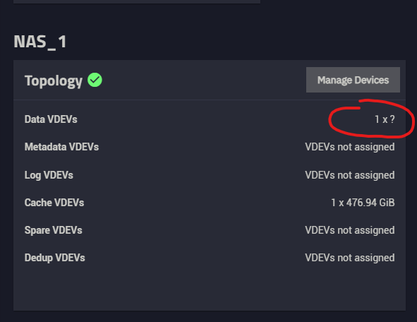

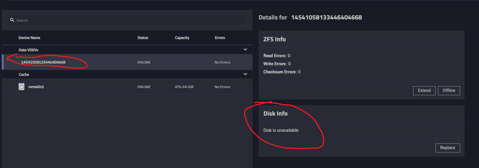

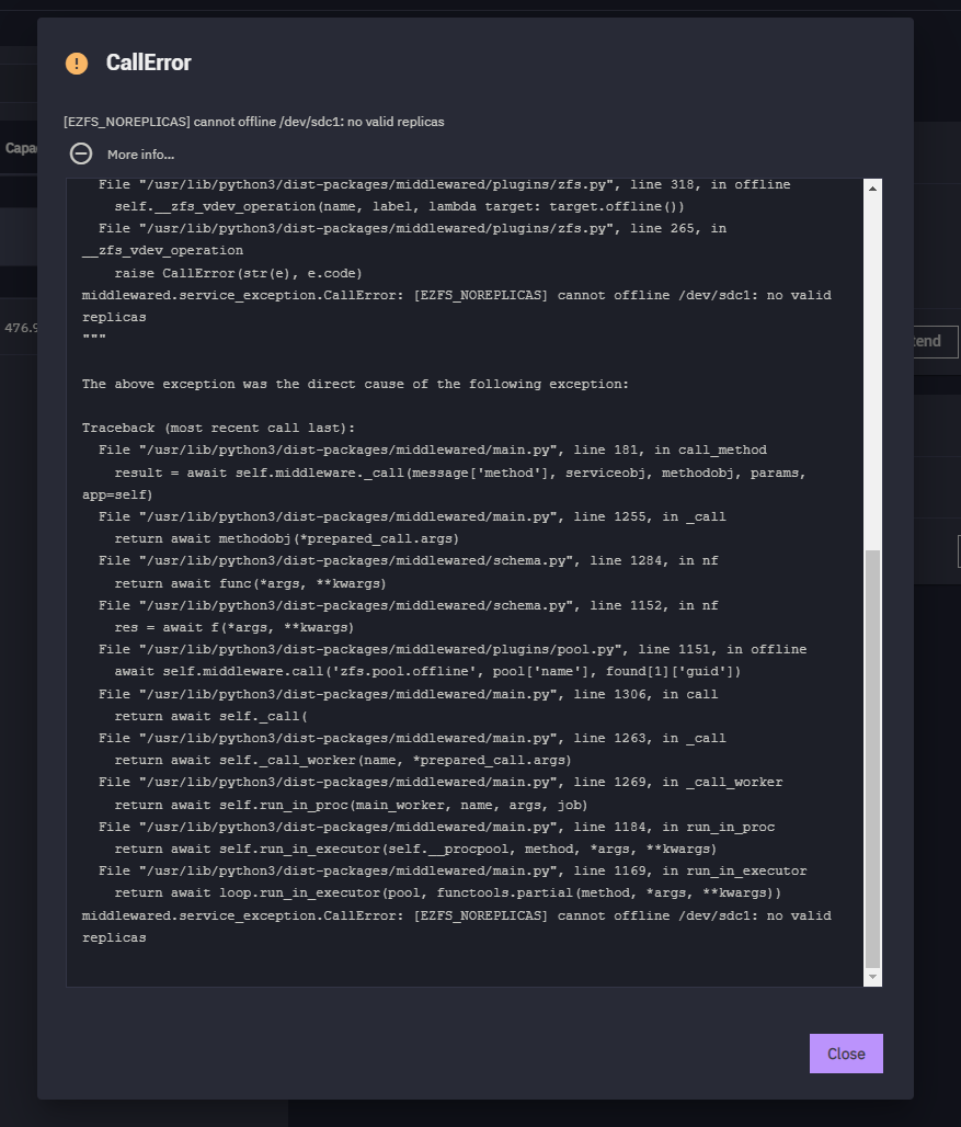

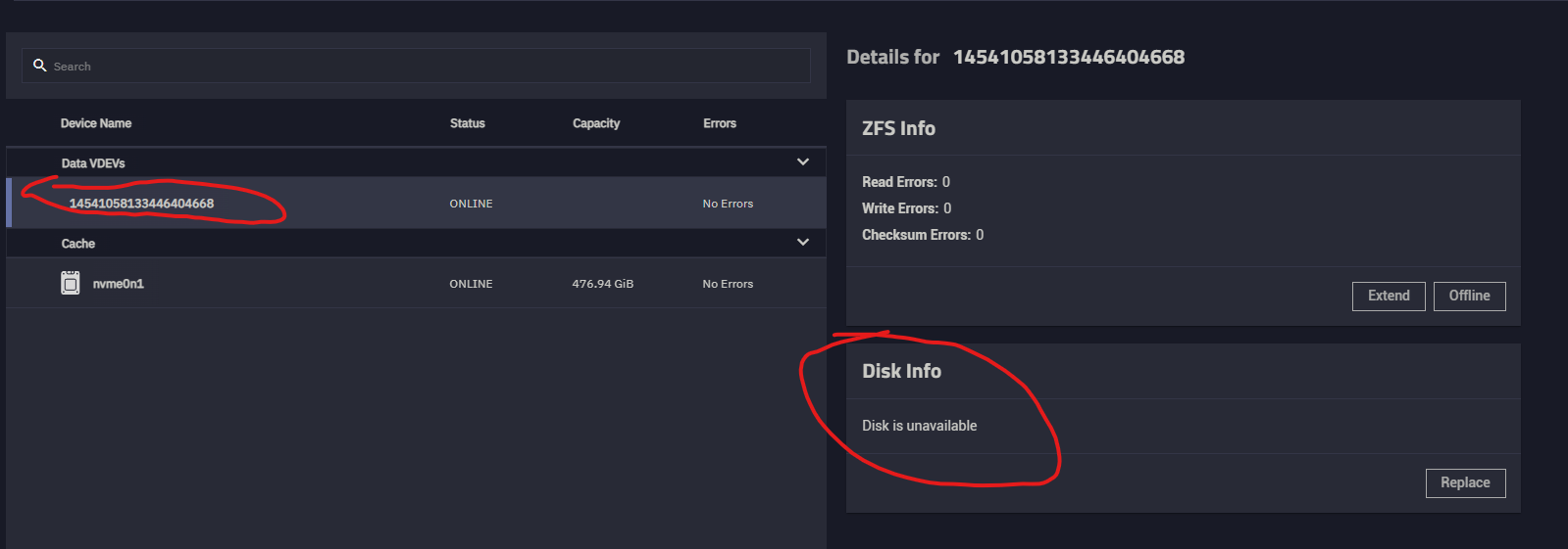

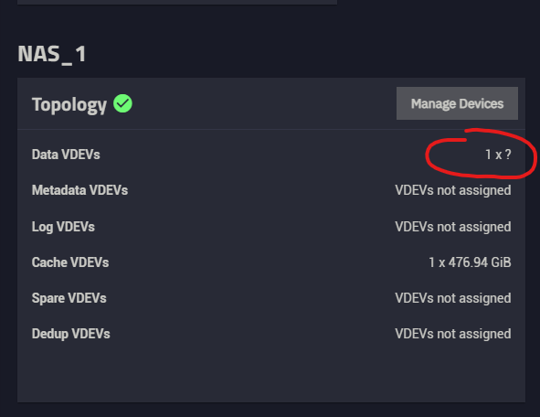

After upgrading, the NEW Storage shows like this:
I tried manage device,

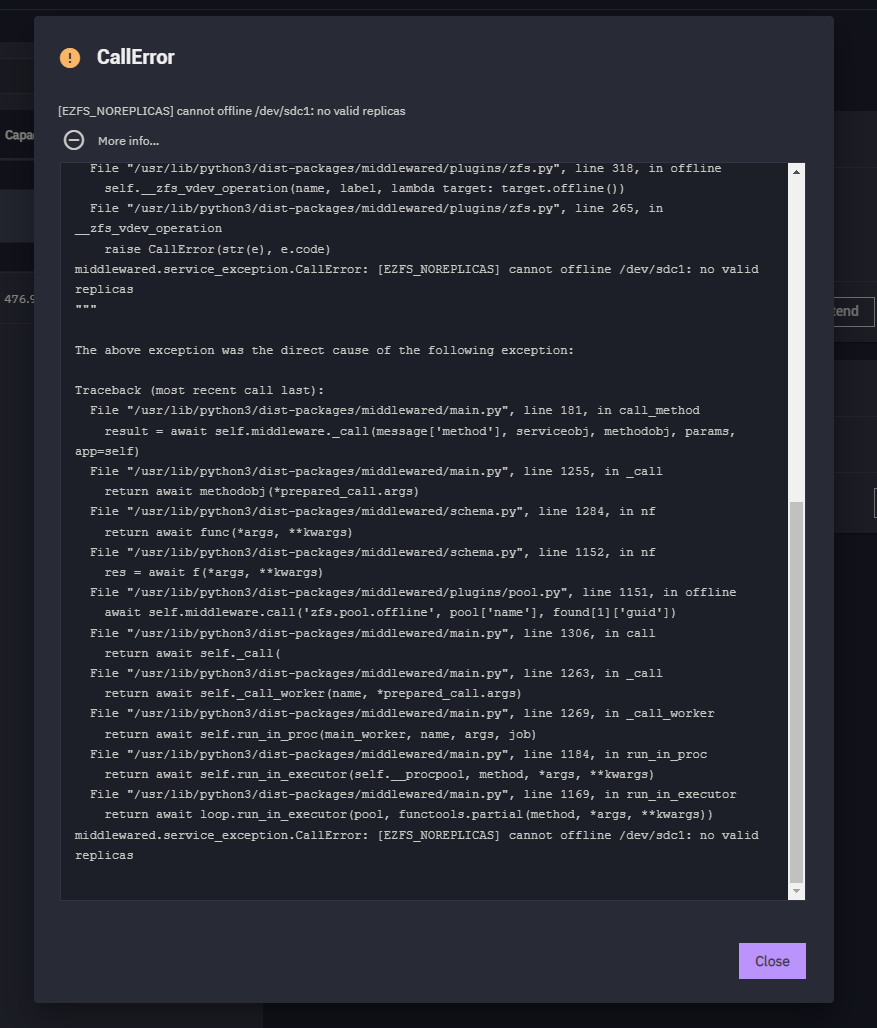

It seems didn't show right data vdevs. I tried to offline it, then this came out
Error: concurrent.futures.process._RemoteTraceback: """ Traceback (most recent call last):  File "/usr/lib/python3/dist-packages/middlewared/plugins/zfs.py", line 263, in __zfs_vdev_operation    op(target, *args)  File "libzfs.pyx", line 465, in libzfs.ZFS.__exit__  File "/usr/lib/python3/dist-packages/middlewared/plugins/zfs.py", line 263, in __zfs_vdev_operation    op(target, *args)  File "/usr/lib/python3/dist-packages/middlewared/plugins/zfs.py", line 318, in <lambda>    self.__zfs_vdev_operation(name, label, lambda target: target.offline())  File "libzfs.pyx", line 2291, in libzfs.ZFSVdev.offline libzfs.ZFSException: cannot offline /dev/sdc1: no valid replicas During handling of the above exception, another exception occurred: Traceback (most recent call last):  File "/usr/lib/python3.9/concurrent/futures/process.py", line 243, in _process_worker    r = call_item.fn(*call_item.args, **call_item.kwargs)  File "/usr/lib/python3/dist-packages/middlewared/worker.py", line 115, in main_worker    res = MIDDLEWARE._run(*call_args)  File "/usr/lib/python3/dist-packages/middlewared/worker.py", line 46, in _run    return self._call(name, serviceobj, methodobj, args, job=job)  File "/usr/lib/python3/dist-packages/middlewared/worker.py", line 40, in _call    return methodobj(*params)  File "/usr/lib/python3/dist-packages/middlewared/worker.py", line 40, in _call    return methodobj(*params)  File "/usr/lib/python3/dist-packages/middlewared/schema.py", line 1288, in nf    return func(*args, **kwargs)  File "/usr/lib/python3/dist-packages/middlewared/plugins/zfs.py", line 318, in offline    self.__zfs_vdev_operation(name, label, lambda target: target.offline())  File "/usr/lib/python3/dist-packages/middlewared/plugins/zfs.py", line 265, in __zfs_vdev_operation    raise CallError(str(e), e.code) middlewared.service_exception.CallError: [EZFS_NOREPLICAS] cannot offline /dev/sdc1: no valid replicas """ The above exception was the direct cause of the following exception: Traceback (most recent call last):  File "/usr/lib/python3/dist-packages/middlewared/main.py", line 181, in call_method    result = await self.middleware._call(message['method'], serviceobj, methodobj, params, app=self)  File "/usr/lib/python3/dist-packages/middlewared/main.py", line 1255, in _call    return await methodobj(*prepared_call.args)  File "/usr/lib/python3/dist-packages/middlewared/schema.py", line 1284, in nf    return await func(*args, **kwargs)  File "/usr/lib/python3/dist-packages/middlewared/schema.py", line 1152, in nf    res = await f(*args, **kwargs)  File "/usr/lib/python3/dist-packages/middlewared/plugins/pool.py", line 1151, in offline    await self.middleware.call('zfs.pool.offline', pool['name'], found[1]['guid'])  File "/usr/lib/python3/dist-packages/middlewared/main.py", line 1306, in call    return await self._call(  File "/usr/lib/python3/dist-packages/middlewared/main.py", line 1263, in _call    return await self._call_worker(name, *prepared_call.args)  File "/usr/lib/python3/dist-packages/middlewared/main.py", line 1269, in _call_worker    return await self.run_in_proc(main_worker, name, args, job)  File "/usr/lib/python3/dist-packages/middlewared/main.py", line 1184, in run_in_proc    return await self.run_in_executor(self.__procpool, method, *args, **kwargs)  File "/usr/lib/python3/dist-packages/middlewared/main.py", line 1169, in run_in_executor    return await loop.run_in_executor(pool, functools.partial(method, *args, **kwargs)) middlewared.service_exception.CallError: [EZFS_NOREPLICAS] cannot offline /dev/sdc1: no valid replicas
I tried shell, seems good, and other functions are good too.
root@truenas-scale[~]# zpool status -v NAS_1
  pool: NAS_1
 state: ONLINE
  scan: scrub repaired 0B in 00:14:54 with 0 errors on Sun Jan 15 00:14:55 2023
config:
    NAME                                    STATE     READ WRITE CKSUM
    NAS_1                                   ONLINE       0     0     0
      sdc1                                  ONLINE       0     0     0
    cache
      847d7bff-d2b0-4950-ba6d-577579c74a6f  ONLINE       0     0     0
I resignned the cache disk, it shows good now.
Want to know if there is way to solve this, thanks!

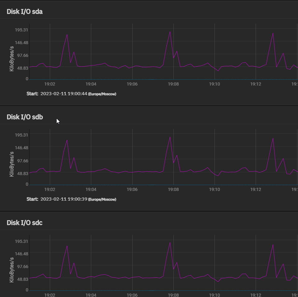

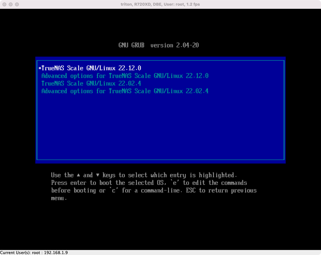

Fingers crossed, started upgrading from TrueNAS-SCALE-22.02.4
Found this bug after some research of regular disk activity in Angelfish
However, installed vibration prevention HDD screws before this :)
BTW - advice 2 all, no mind about future Angelfish updates with the bug fixing, but if you don't want 2 see graph like this and may backup the data in case - migrate.
My SCALE beast is just 4 testing now, and I may easily crash all data on it, however, Imsallling ssd-s with such bug is hmm, not too wise indeed.
  pool: NAS_1
 state: ONLINE
config:
    NAS_1                                   ONLINE       0     0     0
      sdc1                                  ONLINE       0     0     0
    cache
I have a similar issue, in that after upgrading to TrueNAS-SCALE-22.12.2, one of my Pools is showing numerous disks unavailable in the gui, but clearly showing online and in a healthy state through zpool status.
I'm not quite sure I understand what the remediation is for this.
jgreco
Resident Grinch
May 29, 2011
18,680
Could just be a display thing. You have a lot of disks on that system. I'd report it as a bug and guess that large numbers of disks might need some additional tweaking.

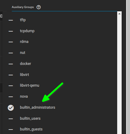

just updated to TrueNAS Scale latest update
I cannot log in to web interface
I have changed by password and it was accepted
If I try to login it denies access
I wash, rinse and repeat process over and over
no matter what password I use the results are the same
I know this is usually simple by pressing #4 and changing password
but will not work for me today
thanks for any help

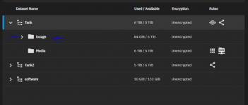

Dumb question here. I upgraded to Bluefin on my server and everything is running smooth and perfect.
Can I destroy the old iocage dataset without harm? My from my understanding of Bluefin, this is no longer needed and all my apps are in the new software->ix-applications dataset. I am never going back to Core even if I could.
I am a little gunshy on doing this, because I have caused a lot of problems in past doing things like this....
